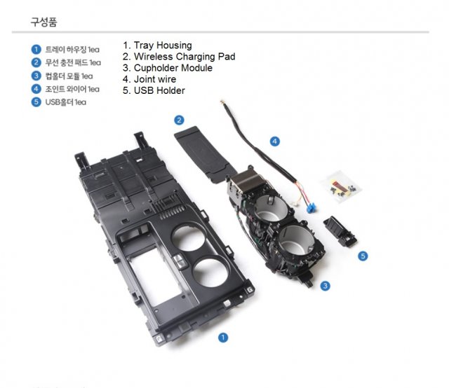

Well I attempted to have the dealership install this and they cannot figure out the wiring for this. The instructions were not included and the only thing that was were directions of use and all in Korean. I was able to get it translated but nothing useful for actual install. Does anyone have insight or knowledge on how to install this or do I currently have a 600 + paperweight?

I just spoke with the dealership again and they cannot determine where to splice in for the harness. Here is the PDF that they sent me from scanned image. This only seems to translate into operations not install. I have spoke with so many people and no one has been able to assist. I have received many youtube videos showing after market installs and other cars but nothing vehicle specific.

That is just page of how to use the cup holder. I will do some research and get back to you.

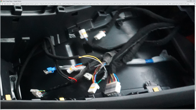

So you just need a wiring diagram for part 4?

I need to get out of the office for a bit. For now, I found this.
I'll find more info in a bit when I'm back.
I somehow missed this last question and I am sorry. Yes you are correct the tech has the console apart and he was trying to figure out what wires to tap into. It looks like the last picture you provided shows the yellow and grey/white one going to the green possibly but not sure on the red black I would imagine it would be the positive negative on that harness. Thanks again for your help so far as I never thought this would be such a pain in the ass to accomplish. I have the tailgate lamp too, so I am sure that will also be an issue with the wiring. SMH!

It seems like the Hyundai tech is throwing in the towel without specifics of what wires to splice into. I appreciate imxkal's help you provided, but I guess it is still not enough info for them to continue on. If you happen to get more information I would still like it and will take on this task myself.
