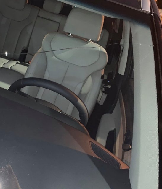

I recently noticed a hairline crack in my windshield that runs across most of the width, then turns upward for about a foot on the passenger side. It is extremely fine and only visible when the car is pointed directly into bright sun. It may not be completely through the thickness of the glass yet. I've only got 5000 miles on the car and absolutely no stone chips or other impacts to the windshield. Just returned from the dealership, where the service manager was able to get a picture of at least part of the crack. He is requesting warranty coverage for a repair. We shall see. Meanwhile I have reported it to NHTSA. Hopefully this will increase pressure on Hyundai to admit there is a problem.
Update: The regional service manager has agreed that my windshield has an internal flaw. Therefore they will cover it under warranty. The bad news is that windshields are backordered and they don't know when one will be available. I guess that is due to lots of breakage and high demand. For a free replacement and no insurance claim I can wait!
I think the takeaway for others is to watch your windshield while driving in sunny conditions, and be alert for any sign of a crack. If you catch one before any coincidental stone chips it will be easier to make the case for warranty coverage.
