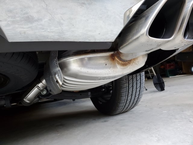

How/where did you get the asymmetric exhaust tips? Or are they actually the same side-to-side and it's the camera lens that makes them look different?
I have a way to get the exhaust tips with the muffler shipped. If anyone is interested just PM me, but they are the same side and match the original. Its slightly angled different since it's on the opposite side but it's not very noticeable. Better than not having it honestly.

Just got semi Quad exhaust installed and its functioning. I will try and do a video and a write up in a week or so.
I got the idea from a photoshopped image of a factory exhaust look and decided to try it in real life.

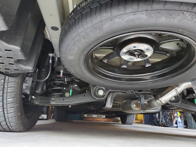

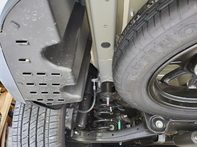

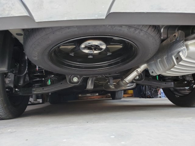

One quick question. I looked underneath my Palisade and noticed the spare tire mounted to the left (driver's side) of the stock exhaust. There is very little room between the spare tire and the driver's side rear tire. Do you have to eliminate the spare tire in order for this to work?

I would say you have to lose the spare tire.

Yes you are going to have to remove the spare but since I have towing with my insurance I decided to do so. You can save the spare if you do not want a 2nd muffler and just want to add functional tips. That's also an option. You would just come off from the end of existing muffler instead of before
