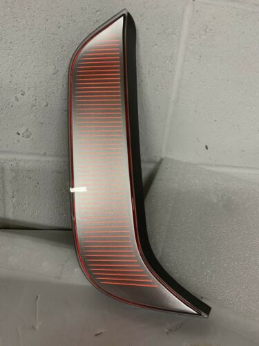

Does anyone happen to know if the stock wiring/connectors for the liftgate trim lights that are usually found on the 2020 Limited and 2021 Calligraphy are generally present on other models? These are the lights on the liftgate that are next to the tail lights but are just unlit silver trim on other models. When I look at the parts list I don't see the lighting harness called out and it doesn't even show the differences in the parts for the lights/trim between the models. I'm wanting to install these lights on my 2021 Limited. I can purchase the stock lights online but can't see anything with regards to the wiring. I hoping not to have to disassemble my lift gate just to find out. I'm fine if I just have to get a different harness but can't identify a part number if in fact they are different. Any help is appreciated.

Thanks for the reply, unfortunately, that's not it. What I'm looking for is for these lights on the tailgate side of the taillights. I'm not sure if that wiring/connector is present in the harness for the non-calligraphy and post 2020 Limited's.

Yeah, that's what I was hoping, I have the lights but only wanted to dismantle the trim once to install them. If the harness isn't there just extra work and risk of messing something up. From my searches can't find any of that portion of the liftgate harness listed anywhere or for that matter the larger wiring harness at all, at least not in the online parts listings.

So I thought I would update you all on my adventure to install these lights on my 2021 Limited. As it turned out the stock wiring did not support these lights but after some research, I found that simply replacing the liftgate harness was a viable option. It took a little time to sort out the part number for the appropriate harness but I finally got there. The part number for the new harness was 91650-S8050. I found a great parts source that ships out of Korea, ( www.sparekorea.com) . Overall it was maybe a little pricy upgrade but adds a little flavor to the design.

Yes, it all went together quite well. Took about 2 hours to swap out the harness but it looks like a factory installation.

Actually, I bought mine in Korea, I travel there for business on occasion. but you may be able to order them from here (http://www.sparekorea.com/). the Part number is 92404S8000 for the right and 92403S8000 for the left. I paid about $100 each. I think you can also find them on Ebay but they are not cheap there. I did see other online sellers, prices varied widely. Sparekorea was very helpful, if they don't list it they may be able to get it for you.
