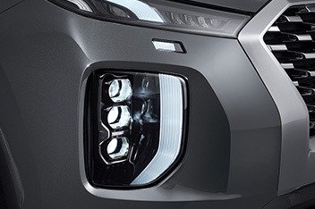

Mario is correct. U.S. gets twin halogen on SE and SEL trims and LEDs on Limited. On the three-beam non-U.S. set-up the upper two lamps are low beam and the lowest is the high beam.

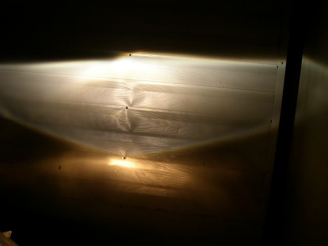

Attached is a photo I took a while back while upgrading one of my vehicles from halogen reflectors to an hid projector based system to compare light output. Halogen on the bottom, projector on the top. You can see that while the halogen light doesn't have as defined as a cutoff, the light output everywhere is significantly lower. The way they deal with minimizing glare for oncoming traffic is to just not put out much light.
