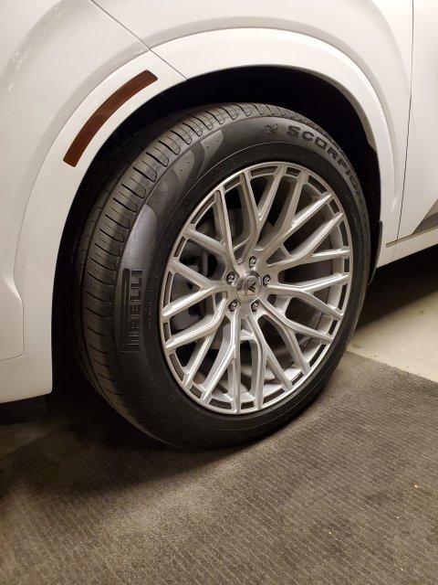

I got 10.5 inch wide wheels from Ashanti (factory wheels are 7.5). I kept the 20 inch size as I didn't want to compromise ride smoothness. Tires are Pirelli Scorpion Verde 285/45/20. Great setup and makes the whole car look much tougher without going overboard. Michelin also makes a tire that size. 16308110031289136863132378198856.jpg

I got 10.5 inch wide wheels from Ashanti (factory wheels are 7.5). I kept the 20 inch size as I didn't want to compromise ride smoothness. Tires are Pirelli Scorpion Verde 285/45/20. Great setup and makes the whole car look much tougher without going overboard. Michelin also makes a tire that size. View attachment 1452
Dirk
If possible can I see a full picture of the car with these rims/tires? They look great!!

Here are some pics. No sacrifice in ride quality - great look. Also removed the badges in the rear (Hyundai logo requires minor body work to fill the holes and paint), medium smoke body film on tail lights and orange side markers, clear bra on front body and all headlights and side view mirrors, overlay logo on the front grill, 70% ceramic tint on front side windows. 20210910_151021.jpg 20210910_151138.jpg 20210910_151146.jpg 20210910_151440.jpg 20210910_151214.jpg 20210911_153033.jpg 20210910_151221.jpg 20210910_151000a.jpg 20210910_151239.jpg

Wheels are ASANTI (typo in above post)
My friend I need to know the exact offset your wheels are! I am getting some 10.5 in wheels too but not sure what offset would fit without rubbing!

I'm not sure about the offset. The guys I worked with took care of that part. The wheel manufacturer (in my case Asanti) was helpful. I do know that I needed hub rings which is pretty common. Sorry I couldn't provide the info you requested.
