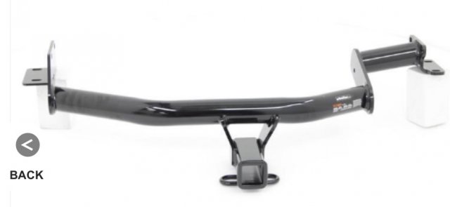

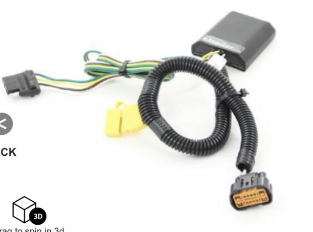

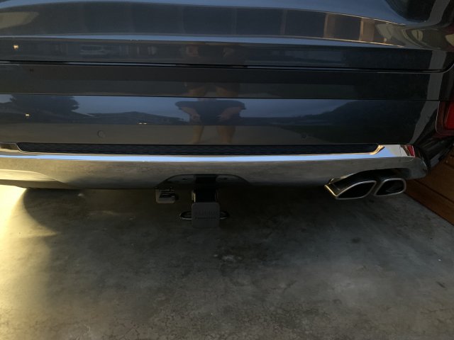

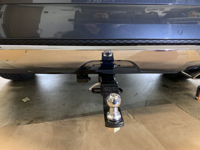

I got the Curt, $172 for the hitch, all is hidden behind bumper but the receiver. The hidden hitch is nice, but expensive and can’t hold as much on the 2“ receiver, ball attachment can though. I also got the $40 curt adapter harness that just plugs in, looks identical to the OEM. The hitch just bolts on, no modification needed. When inserting the through bolts, be sure to insert them on the un-obstructed side and put the nuts on where a heat shield or bolt blocks access. etrailer.com has a video, but the guy forces in the bolts the hard way.
