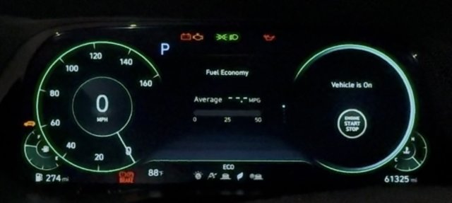

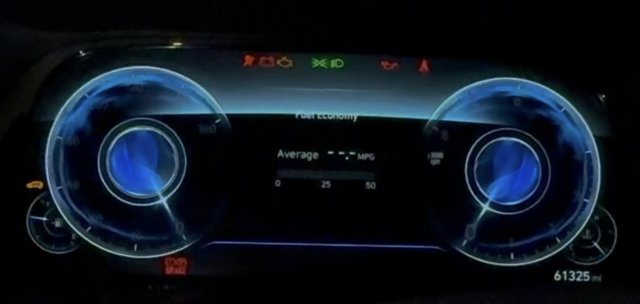

Mine is a 2021 Palisade Calligraphy. When it decides to not start, nothing happens no matter what I do and the brake pedal gets stiff after the first attempt. When I get frustrated and open the door to go check the battery cables on the battery terminals, the act of opening the door makes everything come alive and reboot/reset. I actually got a picture of it coming back online and then it gave the message that the "Vehicle is On". What?!?!?! I beg to disagree!!!
