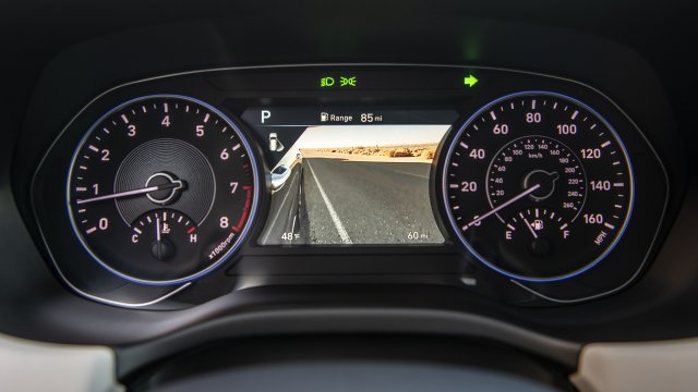

If you don't get the 12.3-inch fully digital display instrument cluster option, you get this layout.
Available on SE and SEL

forgot about the kmh showing all the time on the regular speedometer
